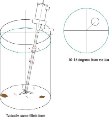

Tank shape and design details are integral parts of the agitator design. Dished bottoms and baffles help prevent settling in cylindrical tanks. Baffles impart a high vertical component of velocity, help eliminate dead zones, and can allow high agitator speeds before aeration occurs. If baffles are undesirable due to slime build-up or heterogeneous reactions, the agitator should be offset and mounted on an angle to reduce swirl and increase vertical motion (Figure 1: 10 degrees -15 degrees from vertical + offset).
Figure 1. Sometimes baffles are a cleaning problem but orientation of the agitator is crucial for good mixing.
Another option is the use of rectangular tanks since the corners provide baffling, especially for these higher viscosity systems. Agitators and impellers aren’t multi-purpose: choices must be made. While an impeller can handle a variety of services its functionality isn’t limitless. The selection of an agitator requires a balance in power consumption, vendor claims, suspension efficiency, attrition (especially in crystallizers), number needed and type of agitator.
The most common impellers for slurries are marine propellers, 4-bladed/45° pitched turbines, and hydrofoils (usually proprietary designs). Two or more impellers may be required, either on separate shafts or on the same shaft, to provide suspension of solids, as well as mixing or blending of the tank. These impellers may, or may not, be of the same type. Often a choice has to be made between the blending or suspending the slurry, while preserving the desired reaction or products in the vessel. A variety of design procedures have been proposed for specifying impeller diameter and shaft speed for a specific duty. One that is widely available is cited in Reference 9.
