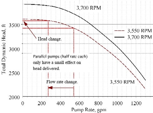

Naturally, at this point, brute force solutions were discussed. The pump already had the maximum size impeller. Reducing the flow rate with parallel pumps has little impact, as moving back on the pump curve (Figure 2) only increases the pump head by 150 ft., which isnt enough.
Figure 2. Matching speed to the head requirements of the feed provides fast payback.

Pump speed is one other factor that can be modified to change pump performance. Pump head varies with the square of pump speed. The affinity law for total dynamic head (TDH) and pump speed (N) in rpm is:
This relationship holds when pump efficiency remains constant.
Pump speed can be varied using adjustable-speed or multiple-speed drivers. In adjustable-speed motors, electronic control enables rpm to be changed to any point within specific ranges. In contrast, multiple-speed motors can operate at more than one particular speed but arent continuously variable. For applications with two vastly different feeds, a multiple-speed drive often provides a very good fit.
However, here, the extra head required for the heavy feed didnt match up well with available standard speed combinations. So, an adjustable-speed driver was selected. It typically operates at either 3,550 or 3,700 rpm. The power savings for the time on the light product more than make up for the lower efficiency of the adjustable-speed motor system. The motor replacement would have had a modest, but justifiable, return simply as an energy-saving project. Factoring in avoided capital costs made the overall economics very attractive.
