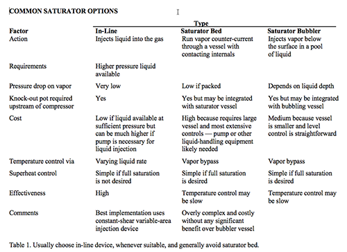

Two types of suction desuperheaters — in-line and saturator bubbler — find widespread use. Another option is a saturator bed. Table 1 compares the three.
Some Saturator Options
Table 1. Usually, choose an in-line device, whenever suitable, and generally avoid the saturator bed.
As long as a liquid source with enough pressure is available, the cheapest option clearly is an in-line desuperheater. It allows easy control of the amount of superheat. This type of desuperheater requires injecting liquid through a spray device into the vapor. This imposes pressure drop on the liquid. The best implementation uses a variable-area constant-shear (constant pressure drop) injection system. This helps keep the liquid drop size constant. Cheaper devices that allow the pressure drop across the nozzle to change with flow rate can have problems with large liquid droplets under some operating conditions.
If liquid isn’t available at high enough pressure, a bubbler often is a good choice. The liquid only needs to be at the gas pressure. Vapor is bubbled through a distributor below the liquid surface to create saturated vapor. If this is acceptable, the equipment is simple and nearly foolproof. Control of superheat, if necessary, will require a temperature control bypass.
The bed approach will work but often requires much higher expenses for internals and controls. So, it’s rarely used. Push back on any proposal to use one to ensure it’s really necessary.
