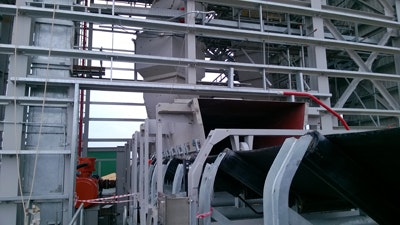

Figure 1. Skirting on belt conveyor at the loading/impact point (tail end) extends sufficiently to reduce dust propagation.

Facilities often have many potential dust generators. For example, belt conveyors can emit dust from different points. The tail end, where material is received, usually is the main point of dust generation because of the many impacts of materials there. However, dust also can come from the conveyor skirting, the return idlers (due to carryback of fine dust on the return belt), and the head end, where material is discharged. With mills or crushers, the size reduction process itself generates significant amount of dust, which can emerge from any uncovered or unsealed parts of the equipment. In addition, material stockpiles often can create dust.
Some other major areas for dust generation are transfer points, chutes and the discharges of hoppers or bunkers. The amount of dust generated in these places depends upon the specifics of how material is handled, unloaded or loaded. Reducing dust generation often is possible. For example, material being discharged onto a belt conveyor should be loaded onto the center of the belt; the material and the belt should travel in the same direction and at the same speed whenever possible.
Where and how the material is discharged are important. Design and configuration of discharge locations should minimize the dust generation. Many facilities use devices such as skirt-boards to keep the material on the conveyor after it’s received. These skirt-boards usually have flat rubber strips or something similar to provide a dust seal between them and the moving belt. These seals require proper design; otherwise short life and operational issues will ensue.
