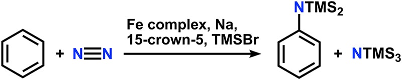

Overall Reaction
Figure 1. Researchers devised a new method for potential future catalytic systems that couple nitrogen atoms with abundant hydrocarbons. Source: Patrick Holland, Yale University.
“There are many known reactions that break C-H bonds for cross-coupling, and many known reactions for reducing N2, even though both are difficult and give a limited number of products. By combining these two powerful reactions, we have a way to put nitrogen atoms from the atmosphere into organic compounds, which is new. And, this was only possible because of the new C-N bond forming step,” Holland elaborates.
