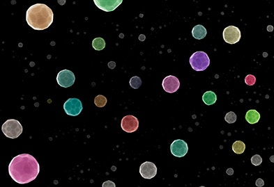

Figure 1. This false color scanning electron microscopy image shows tetrahexahedral nanoparticles that are more catalytically active than those available commercially. Source: Northwestern University.

The multi-faced gem-shape of the catalysts allow atoms at the surface to become more catalytically active than those available commercially. Basic metal precursors combined with heat and stabilizing trace elements rapidly transform the shape into structures that are highly active. The technique doesn’t use ligands that can compromise catalytic activity.
