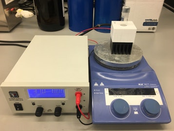

In the retina of the eye, an iminium ion triggers vision when excited by light, the researchers explain. By chemically modifying natural amino acid proline, the Spanish team designed a set of tailored organocatalysts that react with the substrate of the reaction to yield an intermediate (whose formation is clearly indicated by a color change). Shining a high-power purple LED on the chemicals then activates an enantioselective reaction (Figure 1). The approach can produce either enantiomer, depending upon the starting proline chosen.

Figure 1. High-power purple LED prompts enantioselective organocatalytic reaction. Source: Institute of Chemical Research of Catalonia.
