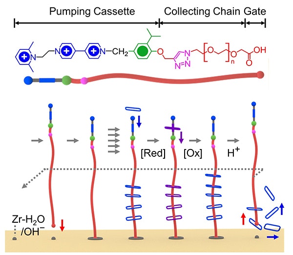

Figure 1. Redox method attracts a fleet of rings on and off the surface of a solid-state two-dimensional metal-organic framework.  Source: Science.

Mechanisorption results from non-equilibrium pumping cassettes forming mechanical bonds between the adsorbent (the surface) and the adsorbate (the molecules). The mechanism uses redox and acid-base chemistry to adsorb and desorb a fleet of rings onto and off the surface of a solid-state two-dimensional metal-organic framework.
