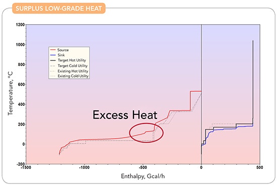

Surplus Low-Grade Heat
Figure 1. Complex 1 had the potential to supply very low pressure steam and hot water. Source: KBC.

As an example, he cites the experience of a client wishing to optimize integration to save energy and capital at a world-scale integrated petrochemical site. Two large facilities there (Complex 1 and Complex 2) had been optimized individually — but TotalSite pinch analysis revealed many valuable opportunities for integration.
For example, the analysis found that Complex 1 potentially could supply very low pressure steam (VLPS) and hot water (Figure 1). However, that facility didn’t have much demand for these. Meanwhile, in Complex 2, Cracker 2 lacked sufficient supplies of low-grade heat (Figure 2).

Complex 2 had been designed with a heat pump on the C3 splitter. Seen in isolation, this was a rational design because Cracker 2 had a heat deficit and could use a heat pump to recover energy from the condenser. However, the integrated design utilizing hot water from Complex 1 provided both operational savings (6 MW for the heat pump compressor) and capital ones (eliminating the cost of the compressor).
“Overall, the complex was able to generate 22MW of power from low-grade heat, while revised driver selection improved steam balance and reduced capital costs.
An operational quick win was identified through examining the whole distillation train. Modelling it allowed clear assessments of the potential energy saving operation while ensuring the process was not compromised,” says McIntee.
