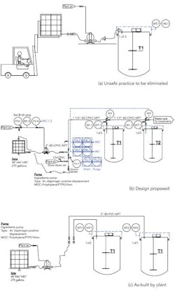

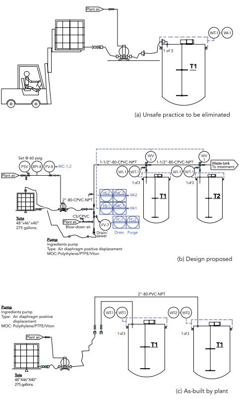

We needed to correct an unsafe practice in our blending area — using a forklift to raise and then hold a tote in place while we pump ingredients into our blending tanks (Figure 1a). Corporate engineering proposed an automated design with six tanks with valves on the top of each tank (Figure 1b) that would cost about $49,000. I thought this was a dumb idea and one for which we’d never get funding anyway, so I had maintenance simplify the design (Figure 1c). We don’t need valves on top of the tank; we’ll control the weight added with a valve near the pump. Because we don’t need valves, we ran individual pipes to each blending tank. What does corporate engineering know anyway?
Unfortunately, we’re having trouble meeting the 1-lb accuracy needed. In addition, we can’t get all the ingredients out of the pipe. Our parking lot is filling up with product rejects. Many ingredients are in the 1–70-cP viscosity range. We tried pumping 990-cP liquid; even the air diaphragm pumps won’t handle it, so we’re hauling it up in buckets.
The corporate engineer says our system won’t work, but the CEO thought it showed initiative at solving the problem on the cheap. The corporate engineer also warns the PVC pipe won’t survive the 180°F water to be used next year for cleaning; his design has CPVC pipe. Is the corporate engineer correct? Did we waste our time?
Send us your comments, suggestions or solutions for this question by October 14, 2016. We’ll include as many of them as possible in the November 2016 issue and all on ChemicalProcessing.com. Send visuals — a sketch is fine. E-mail us at [email protected] or mail to Process Puzzler, Chemical Processing, 1501 E. Woodfield Rd., Suite 400N, Schaumburg, IL 60173. Fax: (630) 467-1120. Please include your name, title, location and company affiliation in the response.
Changed Charging
Figure 1. To replace use of forklift to load ingredients (a), plant didn’t adopt setup suggested by corporate engineering (b) but instead went with an arrangement without valves (c).
