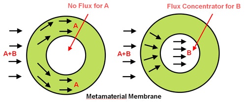

The result is an anisotropic metamaterial — i.e., one whose structure favors flow in certain directions — that can direct a specific chemical around the shell or concentrate it within the shell (Figure 1).
Directed Flow
Figure 1. Metamaterial guides component B to core, enabling more-effective separation from component A. Source: Georgia Institute of Technology.
