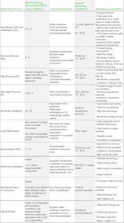

A quantitative comparison of brine concentration approaches shows significant differences in energy requirements (Table 2). The latest data highlights the significant energy advantage of ultra-high-pressure reverse osmosis (UHPRO) compared to conventional electrodialysis/electrodialysis reversal (ED/EDR) and evaporative brine concentrators (EBC), though each technology offers distinct operational benefits and limitations. The values represent theoretical minimums, with actual operational values typically higher due to various system inefficiencies and irreversible losses.
