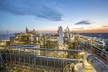

Hydrogen Production
Figure 1. Chlor-alkali complex in Rotterdam generates hydrogen. Source: Nouryon.
