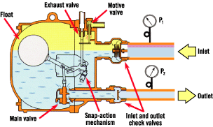

Combination pump and float traps (pump/trap), where the buoyancy of the floating object opens a main trap valve and secondary pressure motive valve. This synchronized combined action allows a higher-pressure vapor to discharge condensate through the main trap valve.

Figure 2. Combination Pump/Trap

Combination pump and float traps.
Many process or heating applications experience a damaging phenomenon known as "stall." A standard mechanical trap design cannot operate and overcome a negative pressure differential. For these applications, a fully synchronized pump and float trap combination, commonly referred to as a "pump/trap," will maintain complete condensate drainage of the system or equipment application.
When the steam pressure in the equipment is less than the return-line pressure, condensate collects in the pump/trap chamber and is forced out through the trap mechanism when the chamber is pressurized. When the pressure in the equipment is greater than the pressure in the return line, the trap section functions as an ordinary trap, and the pump chamber remains almost empty. In this arrangement, the trap mechanism must be a double-seated float type. A high instantaneous flow rate is needed to allow continuous condensate discharge through the trap without constraining the total pump discharge. Ideally, the trap portion should be contained in the pump body to simplify troubleshooting and sizing.
