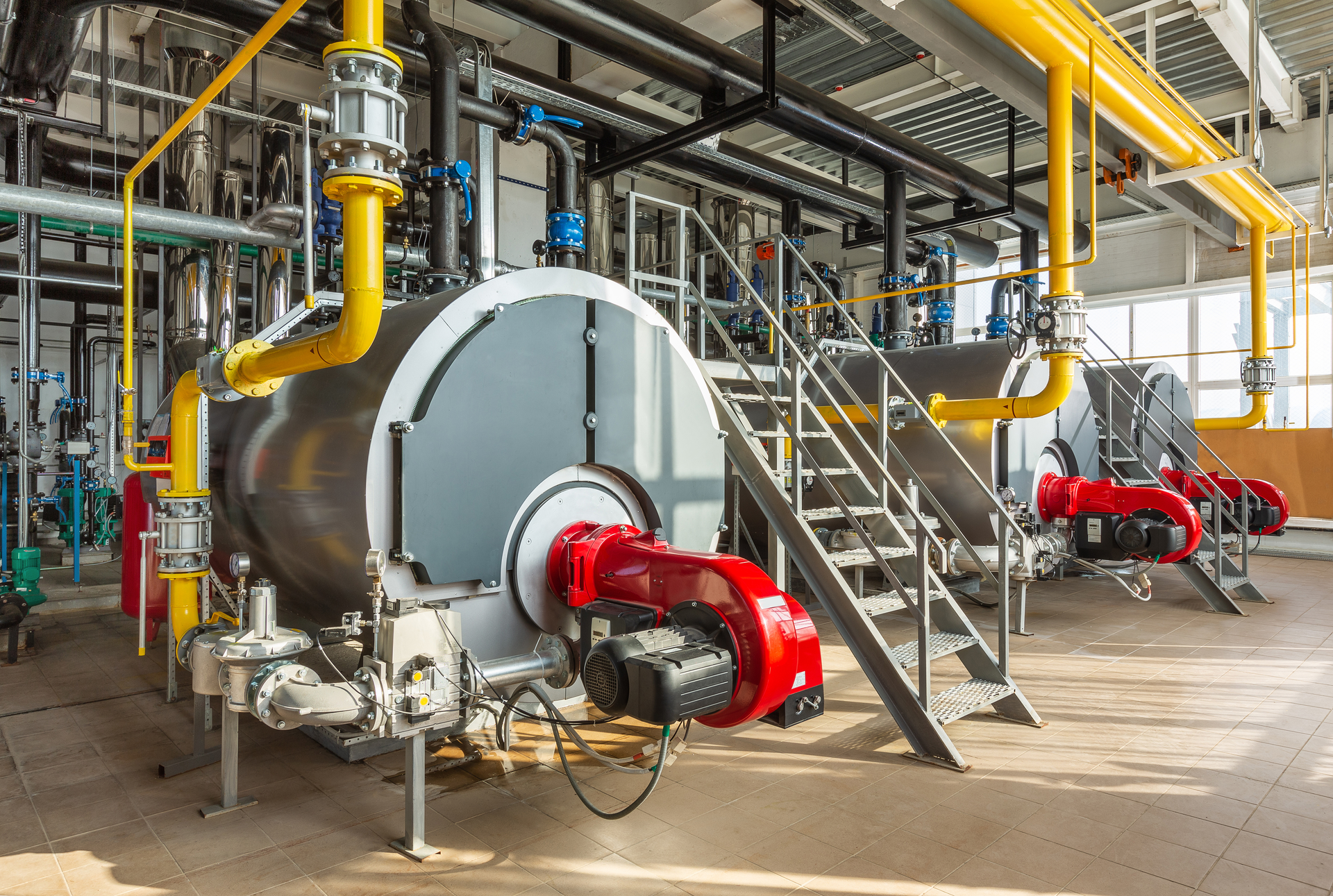

As an example, let’s look at steam systems. Steam is used on all sites for many purposes. These include:
  • Steam reboilers and heaters to process heat or reboil streams
  • Cooling hot process streams and driving steam turbines, which can be back-pressure or condensing steam turbines
  • Stripping steam to improve the quality of a process stream
  • Vacuum ejector systems that use steam when a vacuum is required
  • Steam tracing and tank heating to keep feedstock, intermediate streams and products at a minimum temperature
Let’s explore some of the efficiency issues with these steam systems.

Using back-pressure steam turbines is a highly efficient way to generate shaft power and drive pumps, compressors, fans and blowers. They take advantage of high-pressure steam and produce an equivalent amount of lower-pressure steam. This lower-pressure steam can be used for other heating or stripping-steam purposes in the plant. Typically, the cycle efficiency of these drivers ranges between 80% and 85% depending on the boiler efficiency. As an alternative, let-down systems can generate this lower-pressure steam, yet do not create any shaft power and are therefore quite inefficient. Similarly, condensing turbines are not very effective either because the outlet steam is condensed with cooling water under vacuum conditions. The typical cycle efficiency of these condensing steam turbines falls below 30%.
Considering these scenarios, the best approach to operate your steam system involves:
  1. Generating steam at the highest pressure;
  2. Consuming steam at the lowest possible pressure;
  3. Minimizing the use of let-down systems to generate lower-pressure steam levels;
  4. Maximizing the use of back-pressure steam turbines to balance the need for lower pressure steam; and,
  5. Avoiding the use of condensing steam turbines where possible.
