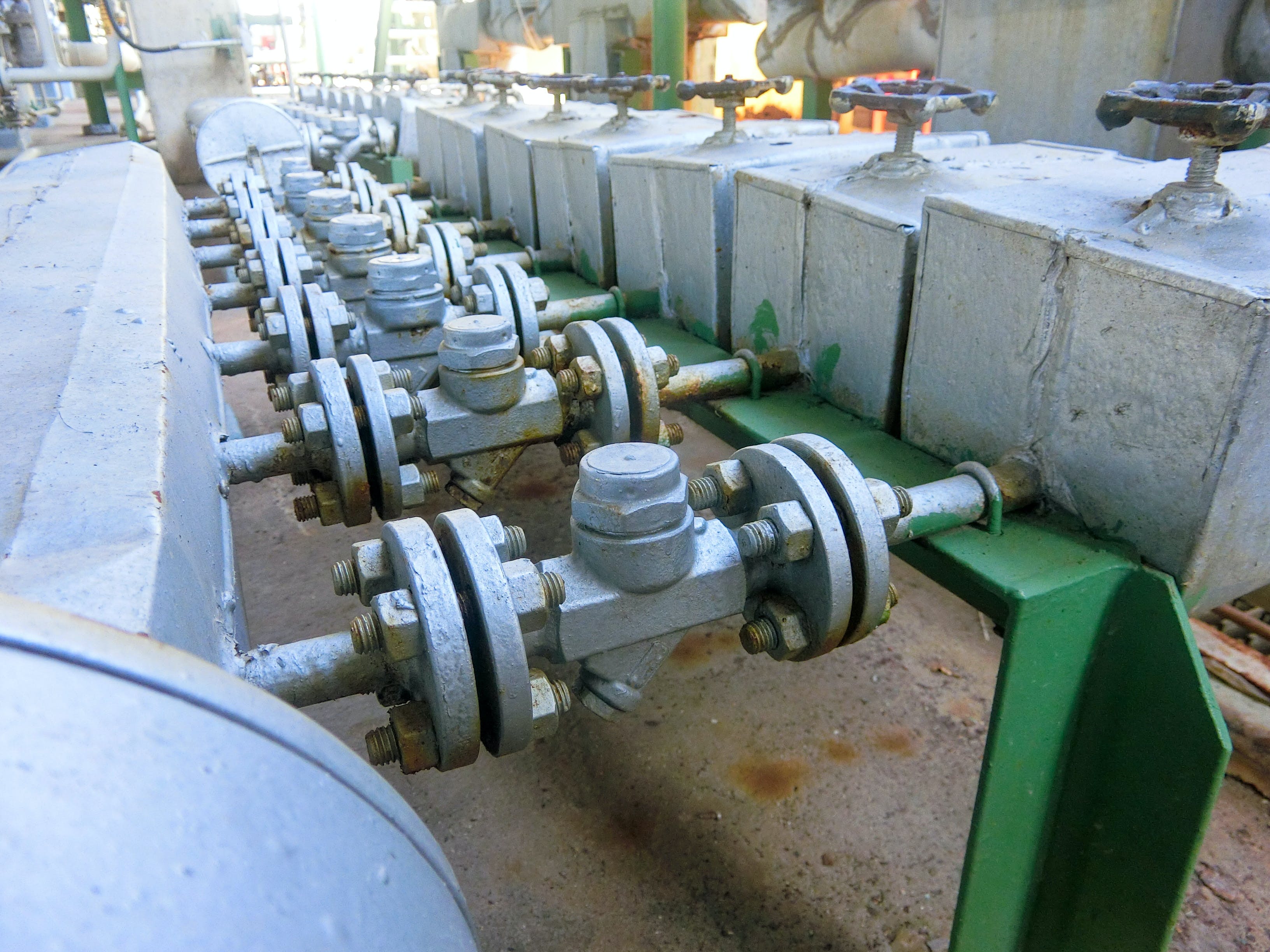

Steam traps play a crucial role in maintaining efficient operation of steam systems in oil refineries and petrochemical plants. These devices remove condensate and non-condensable gases from steam lines to ensure optimal heat transfer in steam users such as heaters, boilers and steam-tracing. They also prevent energy waste. Let’s dive into the design, use and maintenance of steam traps and look at examples of the costs associated with energy waste and operational issues related to steam trap failures.

Energy waste resulting from non-functioning or inefficient steam traps can have significant financial implications.
Use of Steam Traps
Steam traps are strategically installed throughout the steam system in oil refineries and petrochemical plants to effectively remove condensate. These devices work by using different mechanisms to detect and discharge condensate, while preventing steam escape. By maintaining an optimal steam-to-condensate ratio, steam traps help conserve energy and minimize operational costs. Most steam traps are typically associated with steam tracing lines, which maintain process piping and equipment temperatures even when not in use.
During plant visits, I frequently find many non-functioning steam traps. This situation is often attributed to lack of maintenance, trap blockages or significant corrosion. In response, operators generally open a bypass valve around the steam trap and vent an unnecessarily high amount of steam, while draining the condensate to the ground. This is a waste of condensate (that can be reused in the boilers) and steam vented into the air. For instance, a mid-size oil refinery in a cold climate typically has 5,000 to 20,000 steam traps that can result in significant energy waste.
