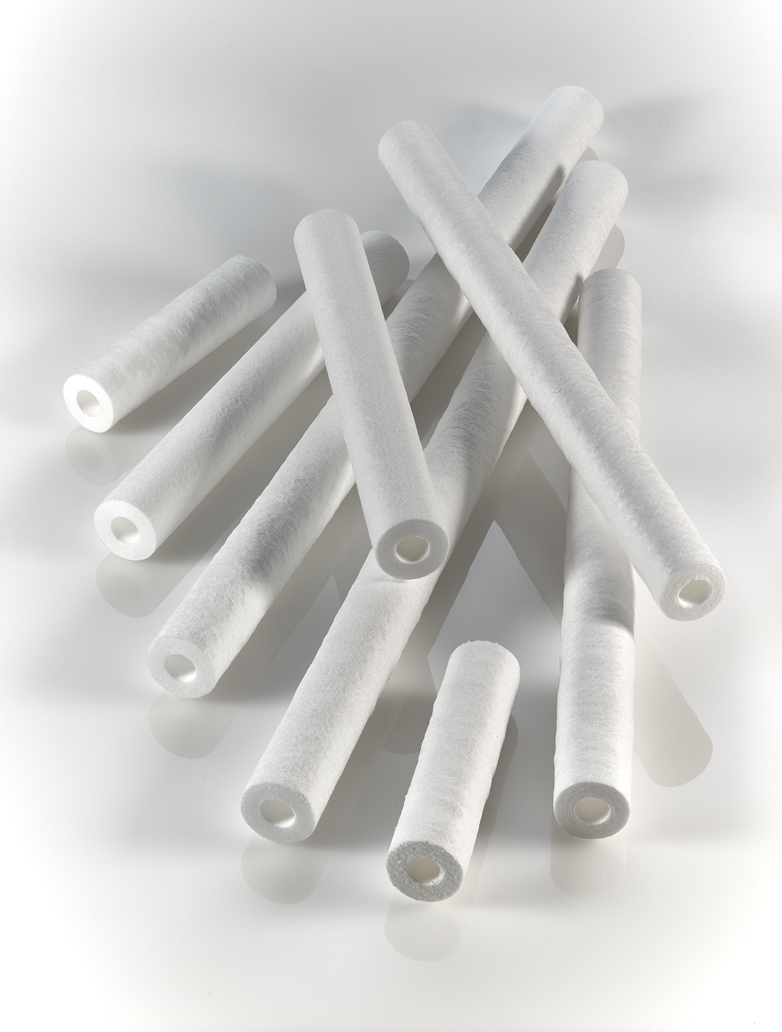

Figure 1. The LOFTREX Nylon filter cartridge product range includes a variety of lengths and pore sizes. In its production processes, Levaco uses filter cartridges with a retention rating of 100 µm.

Eaton suggested polyamide as a possible alternative since it can withstand greater pressure and higher temperatures than polyester or polypropylene. The available filter ratings are approximately equal to those for phenolic resin and may even be better in some cases. The company's Loftrex Nylon filter cartridges (Figure 1) were therefore good for Levaco’s application.
Indeed, the melt-blown filter cartridges made from polyamide can withstand high operating temperatures of up to 248°F and a differential pressure of up to 36 psi at ambient temperatures. The result is a powerful and durable filter cartridge made of a fine-pored material. Its particularly smooth surface also significantly reduces fiber migration — an added benefit for the process at Levaco as any filter fibers released form impurities that can reduce the product quality.
