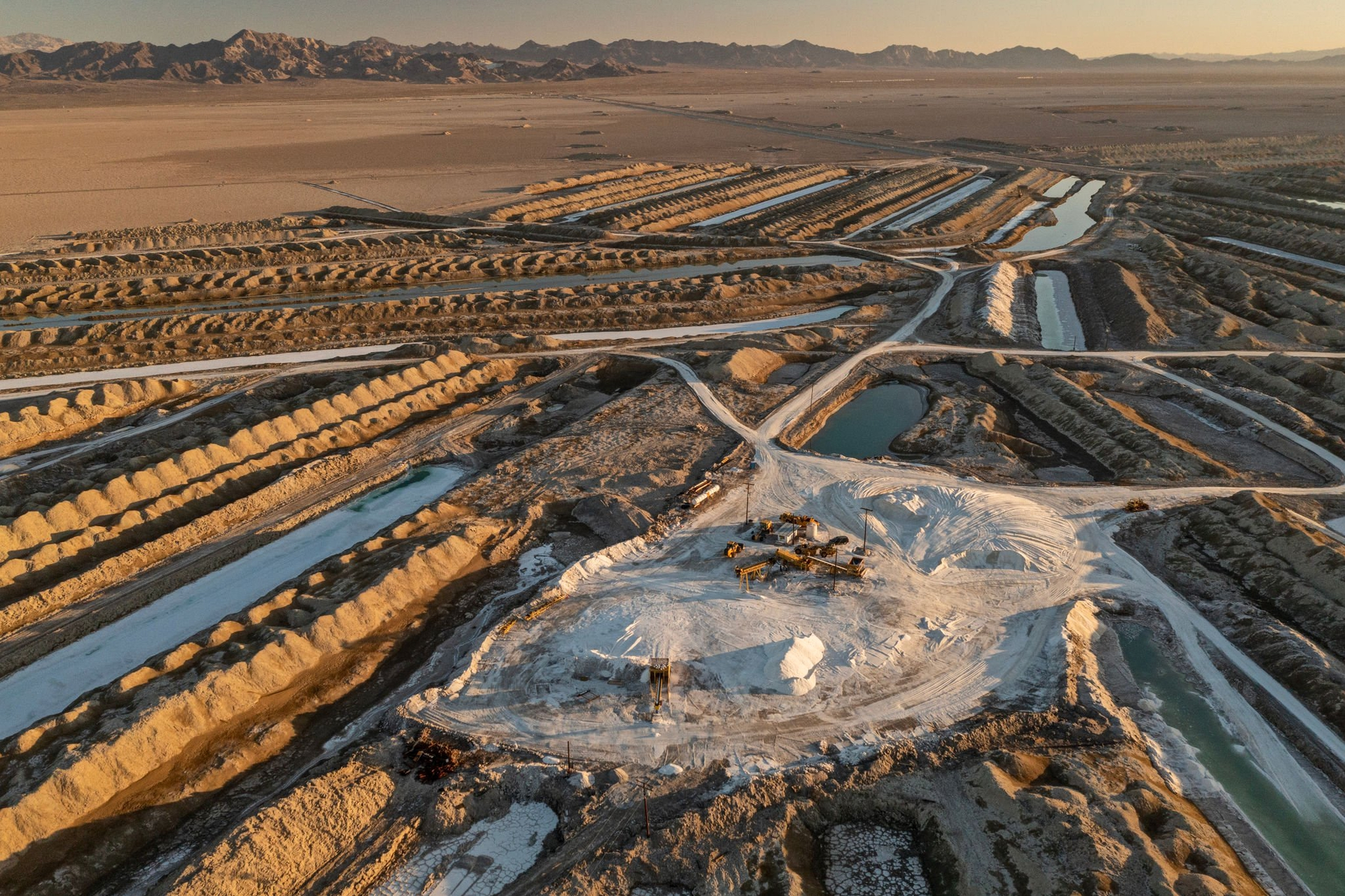

The Brine Approach to Processing Lithium
Lithium brine deposits are accumulations of saline groundwater that producers enrich in dissolved lithium. Methods for extracting lithium from brine are dependent on the particular chemistry found at each deposit. After extracting lithium, producers pump the excess brine back underground.
Brine extraction presents challenges that differ from traditional chemical manufacturing environments. Unlike in a chemical plant where manufacturers can easily identify and reproduce solids and liquids, naturally occurring brines have a wide range of solids concentrations, particle sizes, shapes and characteristics. That’s why producers need to use technology that is flexible enough to handle the variability in the slurry feed and produce the desired quality.
