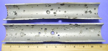

Figure 1. Oxygen can cause severe pitting that can penetrate the wall of a steam generator tube. Source: ChemTreat.

The corrosion mechanism can induce severe metal loss in those areas of high oxygen concentration. The attack often takes the form of pitting (Figure 1), where the concentrated corrosion can cause through-wall penetration and equipment failure in a short period of time.
In addition, oxygen attack will generate corrosion products that then carry over to the steam generator during startups. Deposition of iron oxides in the waterwall tubes leads to loss of thermal efficiency and, most importantly, establishes sites for under-deposit corrosion, such as very insidious hydrogen damage, acid phosphate corrosion (in units with poorly maintained or monitored chemistry — see: “Don’t Get Steamed"), and caustic gouging [2].

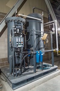

Nitrogen Generator
Figure 2. Unit uses a carbon molecule sieve to separate nitrogen from air. Source: Lincoln Electric System.
Nitrogen blanketing. The first and foremost measure is nitrogen blanketing during shutdown and subsequent short-term layups. Experience has shown that introducing nitrogen to key points in the system before the pressure has totally decayed will minimize ingress of air. Then, as the system continues to cool, only nitrogen enters, not oxygen-laden air. Key points for nitrogen protection in HRSGs include the evaporator, economizer and feedwater circuits.
The nitrogen blanketing system was installed in 2005, just a few years after the steam generators’ startup, when plant personnel discovered oxygen pitting in one of the high-pressure evaporators as well as other corrosion.
One question that often arises is how best to supply nitrogen. Certainly local gas-supply or welding firms can provide bottles of compressed nitrogen. Liquid nitrogen is another possibility. Terry Bundy personnel selected a different method, nitrogen generation via a pressure-swing adsorption (PSA) system. (For more on such units for nitrogen generation, see: “Rethink Nitrogen Supply for Chemical Blanketing.")
The process relies on a carbon molecular sieve that, when compressed air is introduced at high pressure, adsorbs oxygen, carbon dioxide and water vapor but allows nitrogen to pass through (Figure 2). The nitrogen then can be collected in a receiver for use as needed. At a preselected interval, pressure is released from the unit; O2, CO2, and H2O desorb from the material and are vented to atmosphere. The nitrogen purity from this system depends upon production rate, and ranges from 1,000 scfh at 99.5% purity to 248 scfh at 99.99% purity.

The Terry Bundy N2 generator supplies 5-psig nitrogen to the low-pressure and high-pressure drums during wet layups; the nitrogen also serves to “push” water from an HRSG during dry layup draining. A nitrogen pressure of 5 psig is maintained during the dry layup, provided no major tube work is required.
An obvious major concern with nitrogen blanketing — and why some plants don’t use it — is safety. Nitrogen is an asphyxiating agent and requires strict adherence to confined-space entry procedures and proper ventilation of the space.
