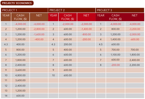

Projects’ Economics
Table 1. The payback periods of Projects 1 and 2 are equal but the long-term returns certainly aren’t.
Consider the three projects whose basic financials appear in Table 1. Both Project 1 and Project 2 have a payback period of 4.3 years. Project 3 has a payback period of 4.5 years but incurs an end-of-life expense that the payback comparison doesn’t include.
An analysis using payback certainly is more straightforward than one using discounted methods. If the earnings are going to be the same every year, the calculation simply involves dividing the expense by the return to determine the payback time. If the expenses or income vary, just add up the yearly amounts until you get a zero balance. Past the zero point, all income is positive.

If all projects had the same life and a smooth cash flow, then few people would criticize using payback analysis for investment decisions. However, different project lives and uneven cash flows make payback analysis less useful. In Table 1, Project 1 and 2 have the same payback period — but Project 1 offers a dramatic profit potential in the later years and will last longer. Project 3 has a different duration and very uneven cash flows. End-of-life outflows (cleanup, demolition and removal) make using payback very questionable.

Going back to Table 1, Project 2 may be attractive today but what happens if Project 1 only comes up next year? The quicker Project 2 returns the money, the more able the firm is to jump onto another project. Having reserve amounts returned as soon as possible maintains flexibility to take advantage of even better opportunities.
