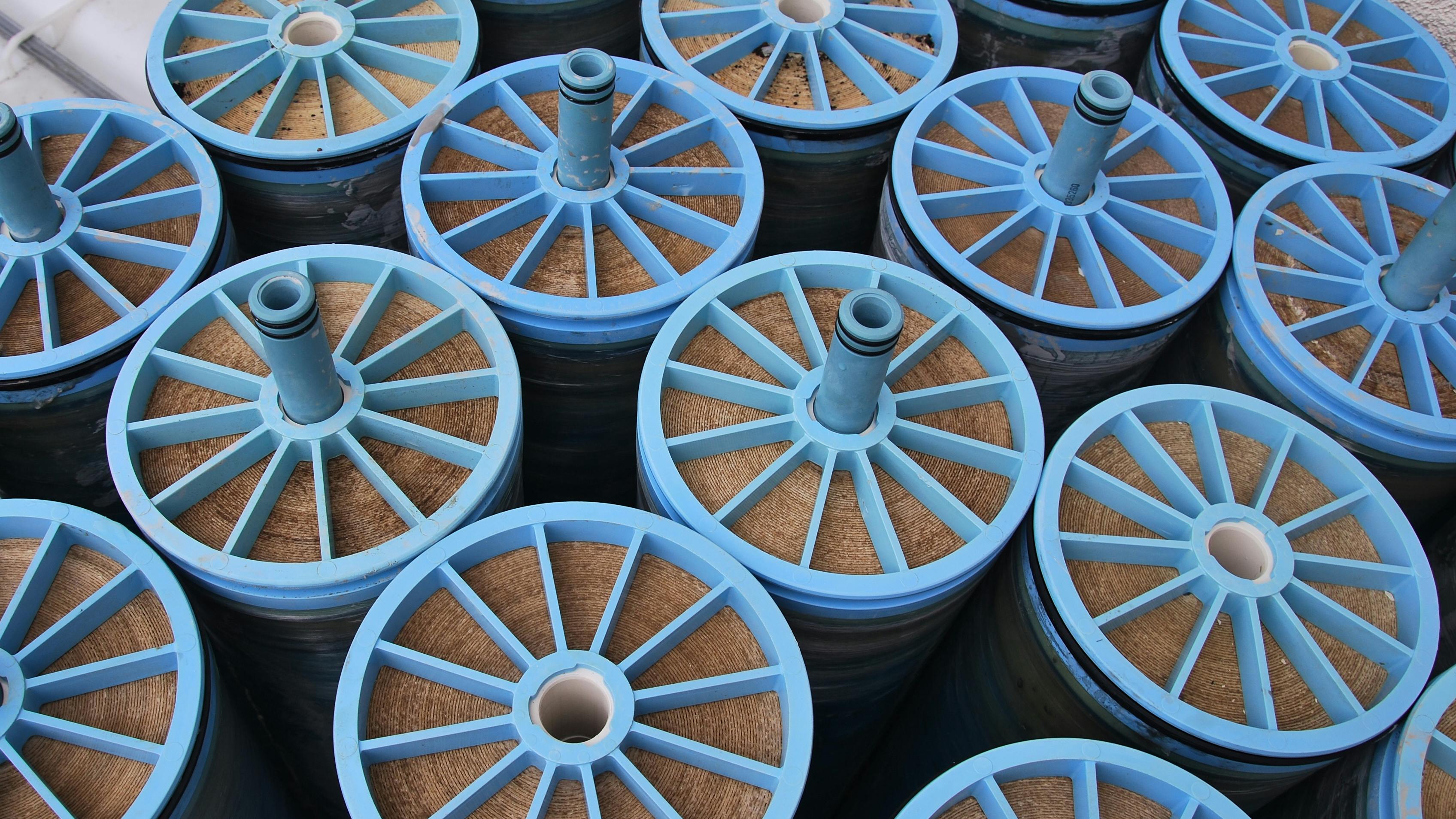

An RO built to the flat-sheet design shown in Figure 3 would take up an enormous amount of space, so the typical arrangement for industrial applications has each membrane wrapped with spacer and support material around a central, perforated tube, all placed in a cylindrical housing. These vessels are known as elements.
In this crossflow filtration process, applied pressure from the RO feed pump forces purified water through the membrane to the perforated central tube. The reject, aka concentrate, exits as a separate stream.
Standard spiral-wound element dimensions are 8 inches in diameter by 40 inches in length. Five or six membranes per pressure vessel is typical.1

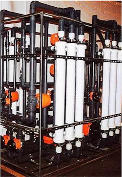

MF and UF are hollow-fiber membrane technologies, with the most common being the pressurized design, where each pressure vessel contains thousands of spaghetti-like membranes.
The process combines crossflow and dead-end filtration, in which many particles exit each vessel in a small waste stream, while some are captured within the membranes. Automatic, periodic off-line cleanings are necessary to prevent irreversible membrane fouling. Space limitations prevent further discussion of MF/UF now, but perhaps I can address the topic in a future Chemical Processing article.
